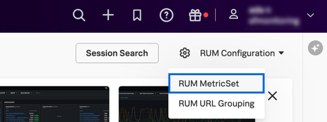

    1. Navigate to the MetricSets configuration page through either of these paths:
      • Select Digital Experience and then in the Real user monitoring section select Overview. On the Overview page, select RUM Configuration > RUM MetricSet as seen in the following screenshot.
        Settings panel for adding metric sets.

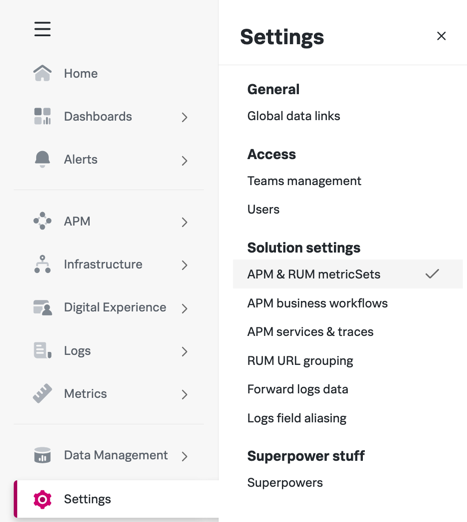

      • From the left navigation menu, select Settings > APM & RUM MetricSets > RUM
