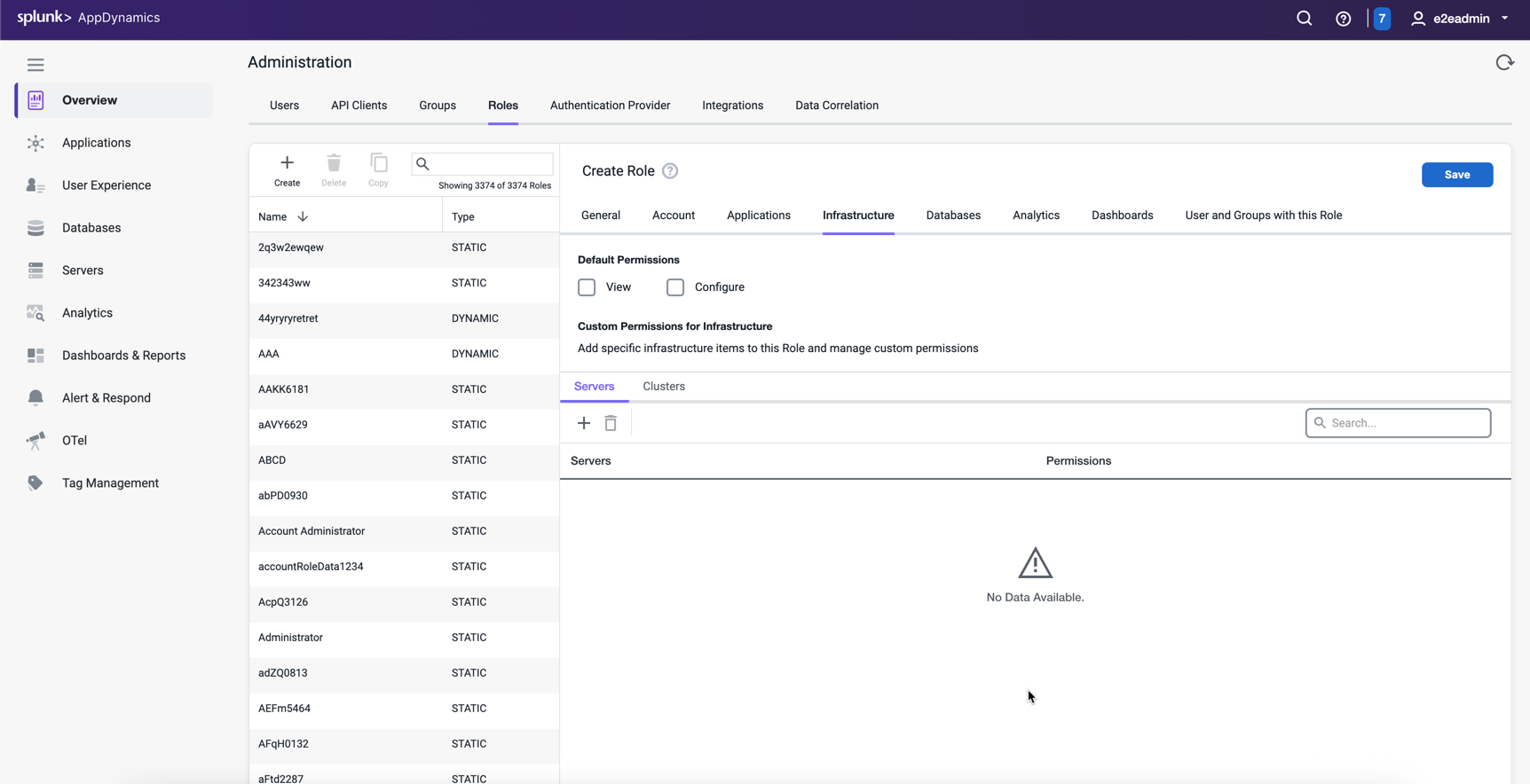

To add the servers to a specific role, on the Controller UI, navigate to the profile icon, then selecting Administration:
  1. Select the Roles tab.
  2. Click Create Role > Create Standard Role .
    Specify the required details such as adding application under Create Role.
  3. Under Infrastructure tab, use the Custom Permissions for Infrastructure section to add the required servers.
    Note: If you require to use this role for an existing application, the administrator needs to remove the existing servers under Applications.
    When you click the Add icon under Servers, the list of all the servers is displayed and you can select the required server, then click Save.

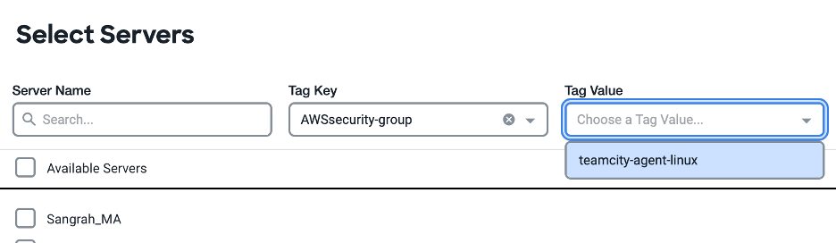

Example Use Case: Assign a Standard Role to a user who only needs to monitor a subset of servers without account-level permissions. For more granular server access control, consider using Dynamic Roles with tag-based filtering.
