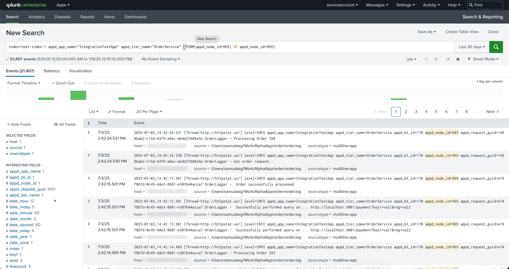

This opens a new tab with the Splunk Enterprise UI where you can view the logs in-context of the node and the selected time range. The selected node is added as a search query on the Splunk Enterprise UI.
For example, in Splunk Enterprise, you can view the following logs related to the node.
Warning: When you navigate to Splunk Enterprise by using the View Logs in Splunk button, you might not be able to view all the log results as per the search query. The search query may contain indexes for which you might have access restriction based on your assigned role. If you want to view such logs, contact your Splunk administrator.
